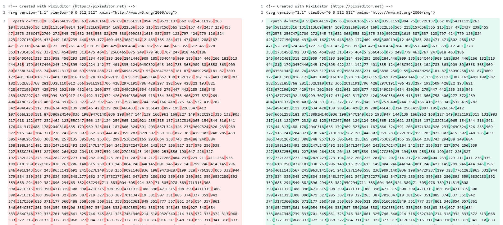

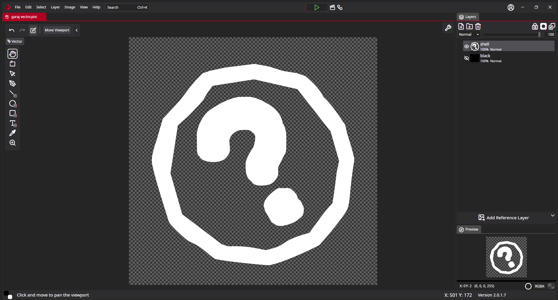

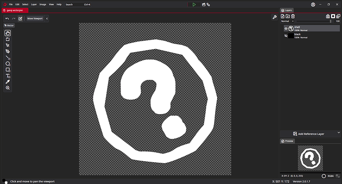

When I export my vector as .svg it’s just a scrambled mess of paths.
It looks normal in PixiEditor or when exported as any other format
I cannot attach any images or send the project file because the forum doesn’t allow me to add attachments. You can find them in discord here

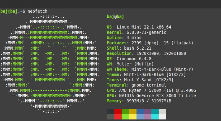

Could you please post the your exported (broken) svg, what system you are running PixiEditor on, and what your SVG viewer is?
info copied from discord:
I use the default SVG viewer in Mint, but the issue is also visible in all other viewers and in photoshop, so this is not a viewer issue

Apparently this is a locale issue. The working SVG file I exported has dots, the broken one has commas

@baj What’s your locale?
