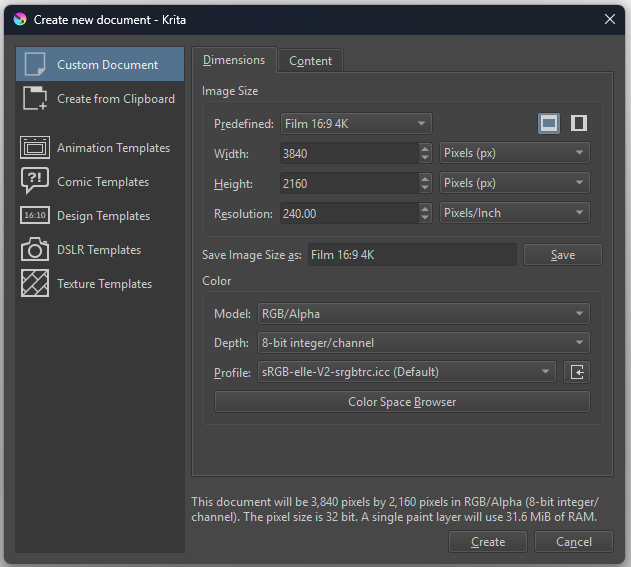

A great example that manages to incorporate essentially all of these aspects would be Kritas document creation menu:
(In the predefined they not only have digital size formats but also paper sizes)
