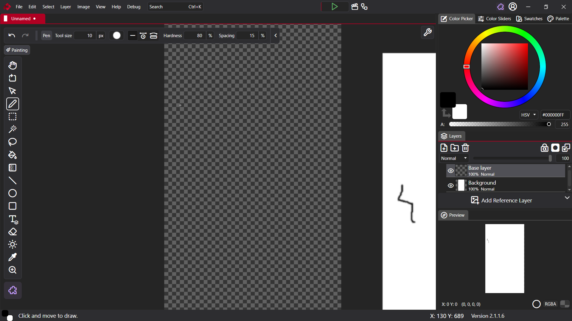

Zoom cause drawings to be off canvas
At a certain zoom level the drawings is just not where it should be, this only applies to high resolution canvas
This issue was there in older version, I thought someone has already reported this but turns out it’s not
It seems to be happening pretty randomly, I tried replicating that, but with no luck. I guess it happens for you every time for same dimensions?
